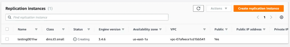

  6. It will take a few minutes for the replication instance to spin up. Coffee time!
    Replication instance

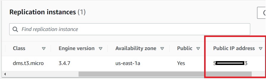

  7. Once it’s ready, we’ll need to get the Public IP address for our replication instance. You should see it in the table on the Replication Instances console.

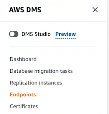

  8. Now it is time to establish a connection to both source and destination DB endpoints. Go to the Endpoints section. On the right you’ll see a Create Endpoint button, click it.
