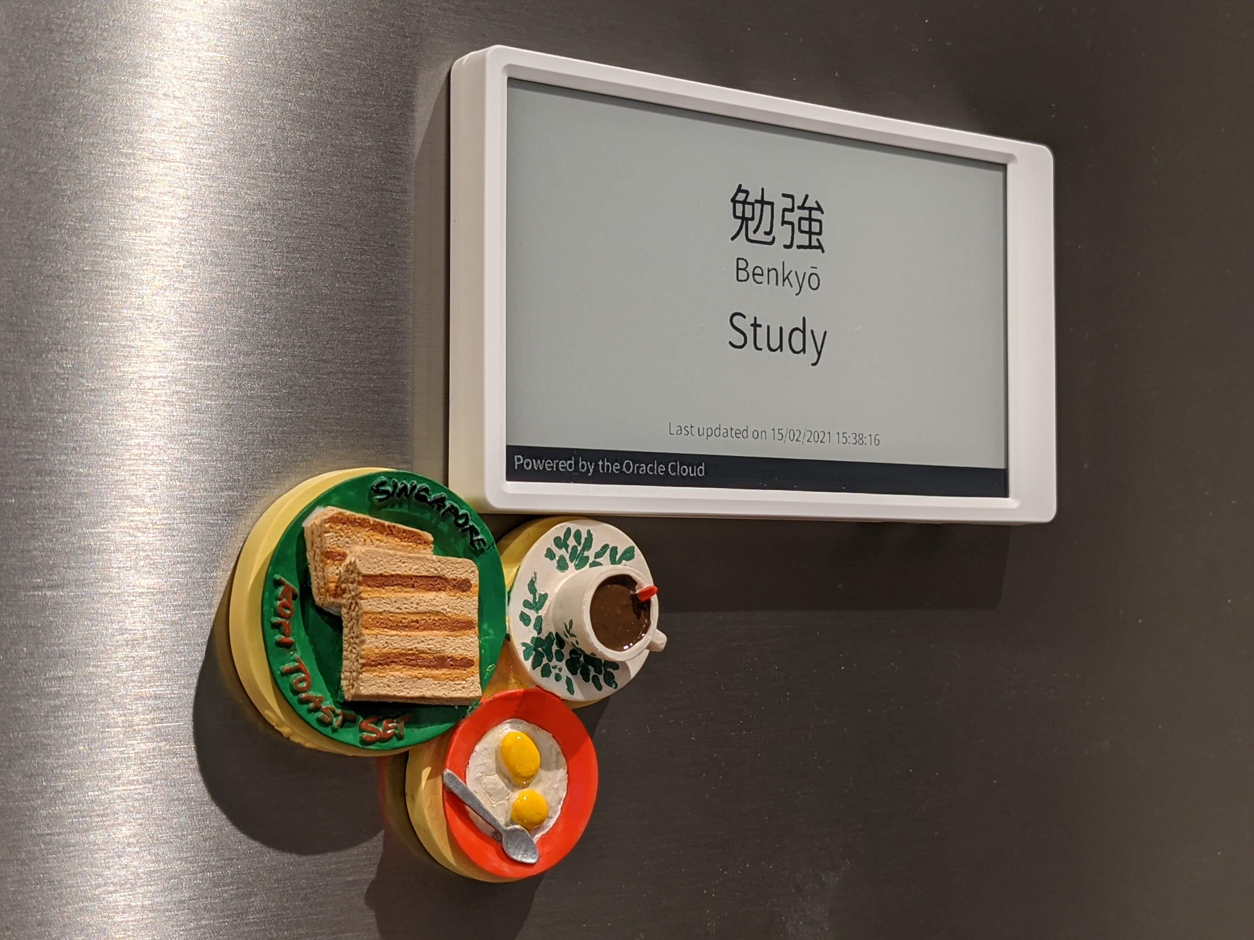

Here’s what it looks like upon completion:
The electronic flashcard powered by the Oracle Cloud
All that in a weekend of fun!

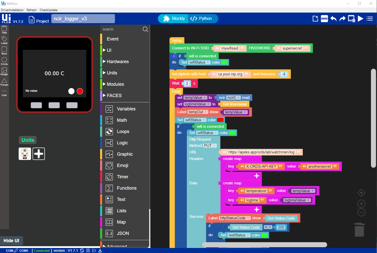

UIFlow
As with many ESP32-based products, the M5Paper supports both Arduino and MicroPython. M5Stack also provides their UIFlow firmware, which is based on MicroPython. It contains APIs that make working with compatible sensor products, and is easily programmable with their graphical Integrated Development Environment (IDE). Developers can choose to program the device using either the Blockly interface, or straight up MicroPython.
UIFlow makes programming M5Stack products easy.
At the time of writing, the alpha version of the IDE supports and is certainly a great option to consider. Like APEX, it is designed for rapid application development!
While I like the “RADiness” of Blockly, I eventually decided to go with Arduino for two reasons. Firstly, the Arduino libraries appear to be more matured and better documented. The other reason was the ease of adding fonts to the application. As this is a multilingual application, I needed to use a font library that supported unicode characters and it was much easier and straightforward to do when programming with Arduino.

void setup() {
            canvas.loadFont("/GenSenRounded-R.ttf", SD); // Load the font from the MicroSD card.
            canvas.createCanvas(960, 540); // Create the canvas with the maximum dimension of the e-paper in landscape orientation.
The code to render the display are divided into two functions, displayContent and displayFooter. There are three lines of text for rendering the Japanese characters, Romaji and English translations respectively. Text in all three lines are center-aligned, while the single line in the footer are left-aligned.
void displayContent(String jpnText, String romaji, String engText) {
            canvas.fillCanvas(0);
            uint16_t x = (960 - canvas.textWidth(jpnText)) / 2;
            uint16_t y = 100;
            canvas.createRender(JPN_FONT_SIZE, 256);
            canvas.setTextColor(15);
            canvas.setTextSize(JPN_FONT_SIZE);
            canvas.setTextDatum(TC_DATUM);
            canvas.drawString(jpnText, x, y);
            canvas.destoryRender(0);
        void displayFooter(String text) {
            uint16_t x = 20;
            uint16_t y = SCREEN_HEIGHT - FOOTER_BAR_HEIGHT / 2;
            canvas.fillRect(0, SCREEN_HEIGHT - FOOTER_BAR_HEIGHT, SCREEN_WIDTH, FOOTER_BAR_HEIGHT, 15);
            canvas.createRender(24, 256);
            canvas.setTextSize(24);
            canvas.setTextColor(0);
            canvas.setTextDatum(CL_DATUM);
            canvas.drawString(text, x, y);
            canvas.pushCanvas(0, 0, UPDATE_MODE_DU);
